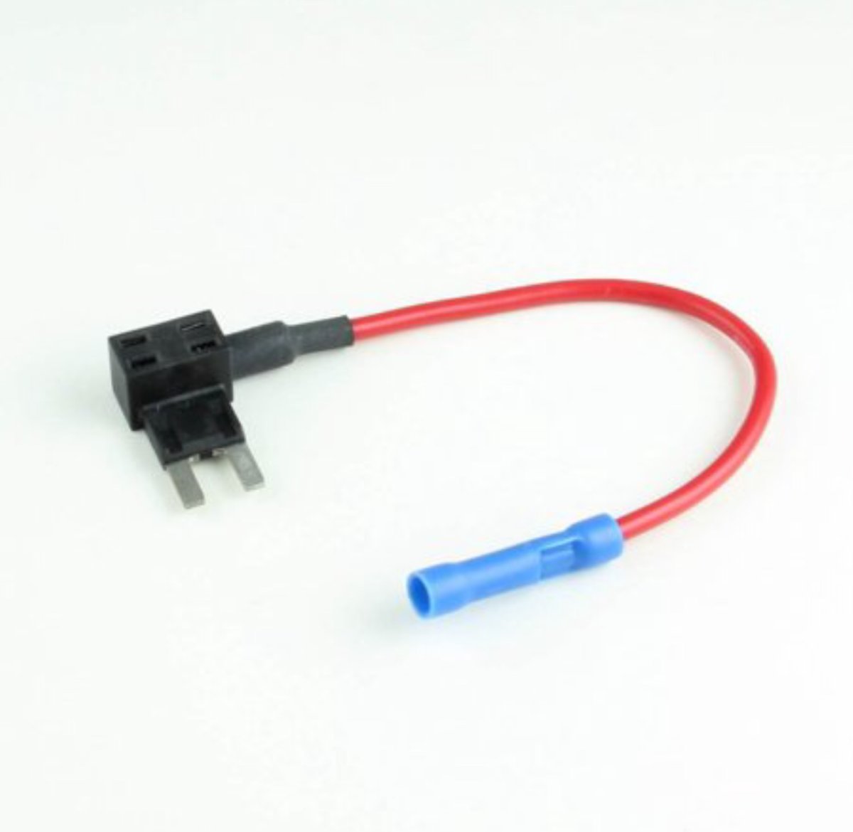

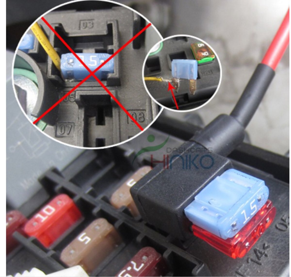

i think he may be asking how to open the box to install a fuse in an empty slot, not just how to open the cover. I don’t know how to open it either so this past weekend, i took another members advice and used a tap fuse wire, which i did not know was a thing.
View attachment 1968View attachment 1969
Where can I find the tap wire fuse
Auto parts store?
Auto parts store?
any auto store, amazon. But as stated before the power is continous if you wanted to turn it off, as I did, then the next stop for the wire would be a toggle/rocker switch, then off to its final stop. I just needed a small amount of power for an LED light for license plate light. I went the tap fuse route because I gave up on finding a Remote\ACC line. I can only imagine the location of the unfindable Remote/ACC line is to follow in a reply by a much more astute Roxor member.
